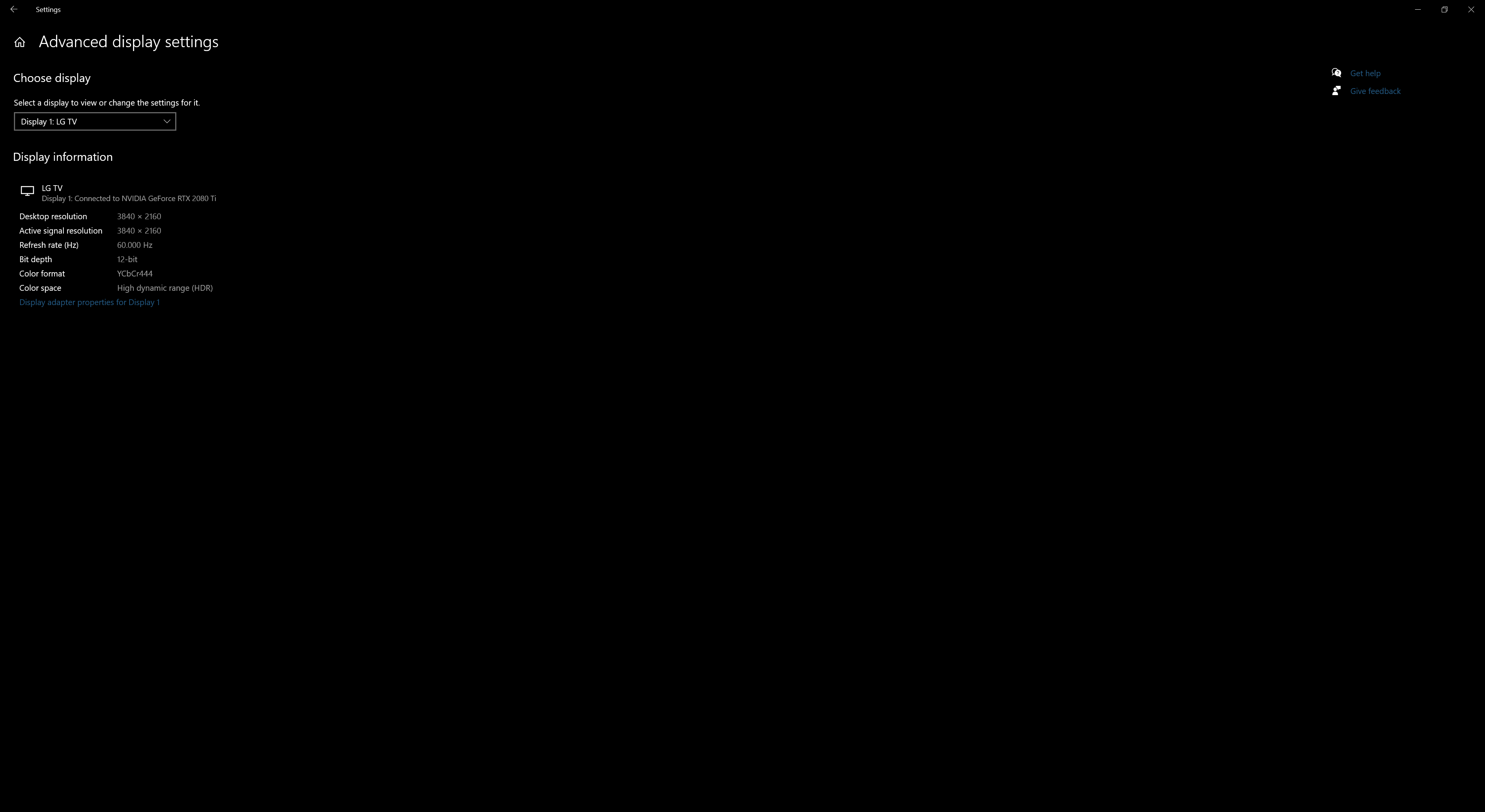

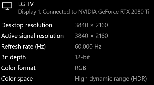

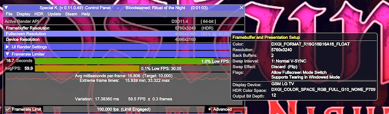

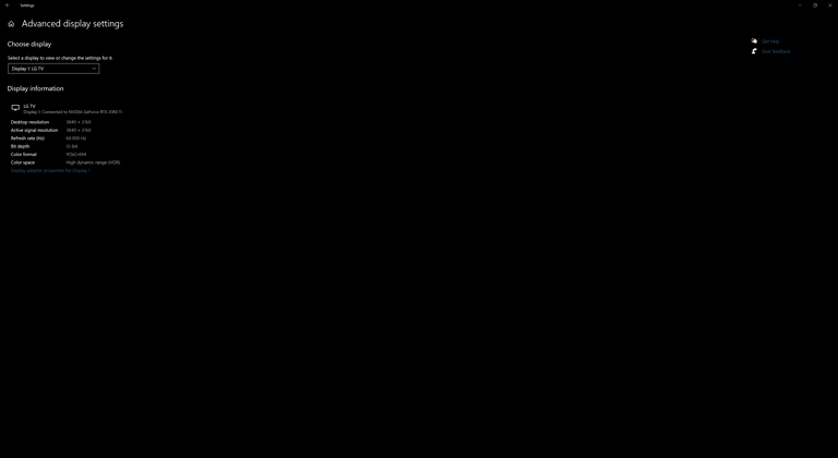

My combination of DP 1.4 → HDMI 2.1 → HDMI 2.0 Fiber-Optic → LG TV on other end of house didn’t quite pan out the way I had hoped, but…
4K 12-Bit RGB @ 60 Hz is working.
And it is glorious, compared to 4K 8-bit HDR :slight_smile: Most games don’t even have a framebuffer with enough color precision to use this signal correctly.
Off the top of my head, the only games that come to mind are Far Cry 5, and Final Fantasy XV. Everyone else cheaps out and uses 10-bit HDR.

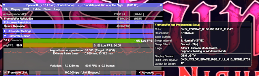

Oh, and with SK’s Display menu, you can even override the system into doing this:
12-bit YCbCr 4:4:4, the NVCPL doesn’t even let you select that.

What’s the perceivable difference between 12 bit and 10 bit? Don’t know if that’s a dumb question XD I’m assuming it just allows for more shades of colour.
The panel itself is 10-bit, so the difference is down to post-processing done by the TV in non-PC picture modes.
Less color banding if a game’s not doing a good job tonemapping its HDR image to your actual display device’s capabilities (which is basically all of them at the moment).

Absolutely. This is where Fullscreen Exclusive + Flip Model becomes an actual thing.
Flip Model is needed to run a DXGI game in “Advanced Color Mode” (HDR in other words), but borderless window mode constrains you to the pixel format and refresh rate of the DWM. Of course, 99.999% of games in existence are going to not bother with any of this stuff, they will just “turn HDR on” and offer refresh rate settings (if you are lucky), none will ever let you select color encoding.
That’s why NVCPL needs a bit of work. It doesn’t expose all of these color encodings that are actually possible to run the DWM in and by extension any HDR game you happen to run. You really need to be mindful of the color format the DWM is using, it’s not talked about enough.

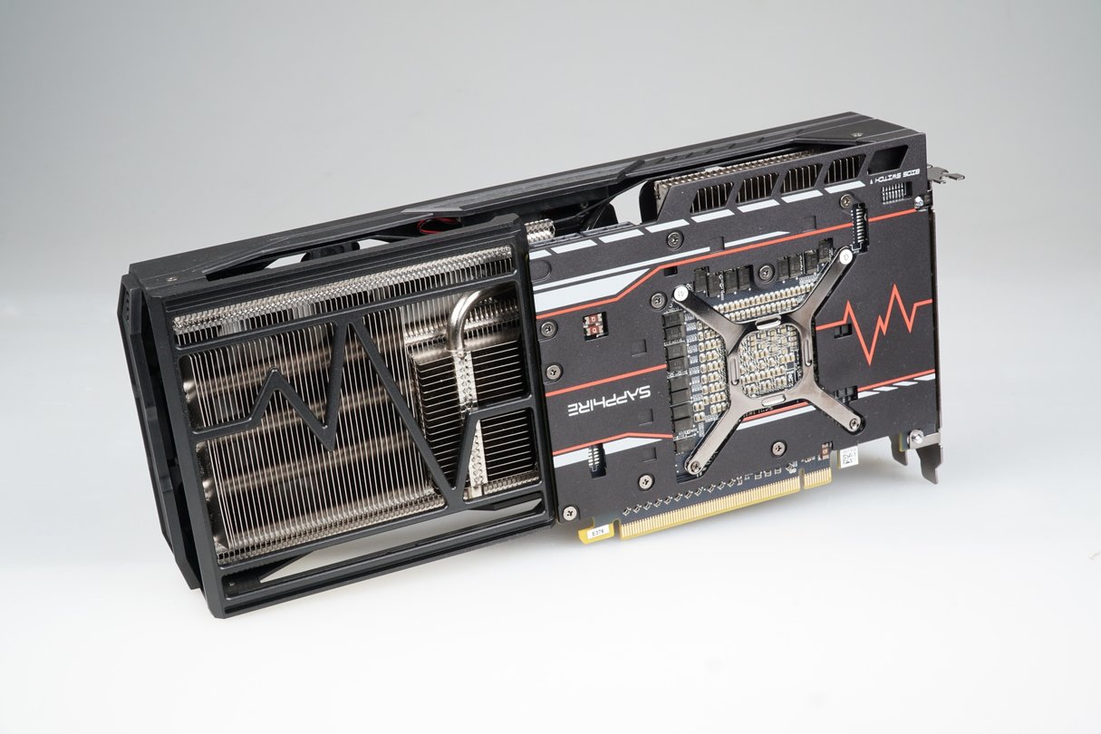

And that’s surprising if a blower design actually works at this size.

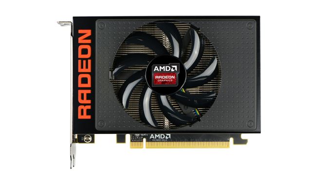

AMD’s Nano variant of the Fury GPU though the 1050 might be a bit smaller still.
Lowest clocked yet highest binned Radeon Fury GPU chips due to the stricter voltage requirements, made for some variants using the Nano PCB and higher binned GPU chips for third party designs with the cooler over the PCB’s actual length. :smiley:
Pretty good too and a bit of a interesting choice for being a fairly high-end product from how I remember though lower clocked unless unlocked.
EDIT: Suppose blowing air everywhere is also a thing since yeah not sure the short length is optimal for how the blower design is meant with a back fan and heat transferred through the cooling plate and fins out the front end of the GPU.
Has to make the air a bit hotter at least plus a bit of air blown around the GPU itself not just transferred out when it’s these shorter designs.
EDIT: PCB Size would be easier with HBM type memory too but that’s costlier and there’s still the VRM’s and other circuitry the memory chips are still pretty close to the GPU most of the time but it opens up for some form factors when the GPU die also houses the VRAM bits directly.
(And some challenges for cooling and the complications like the memory connectivity to the GPU and all that wiring for the interposer.)
